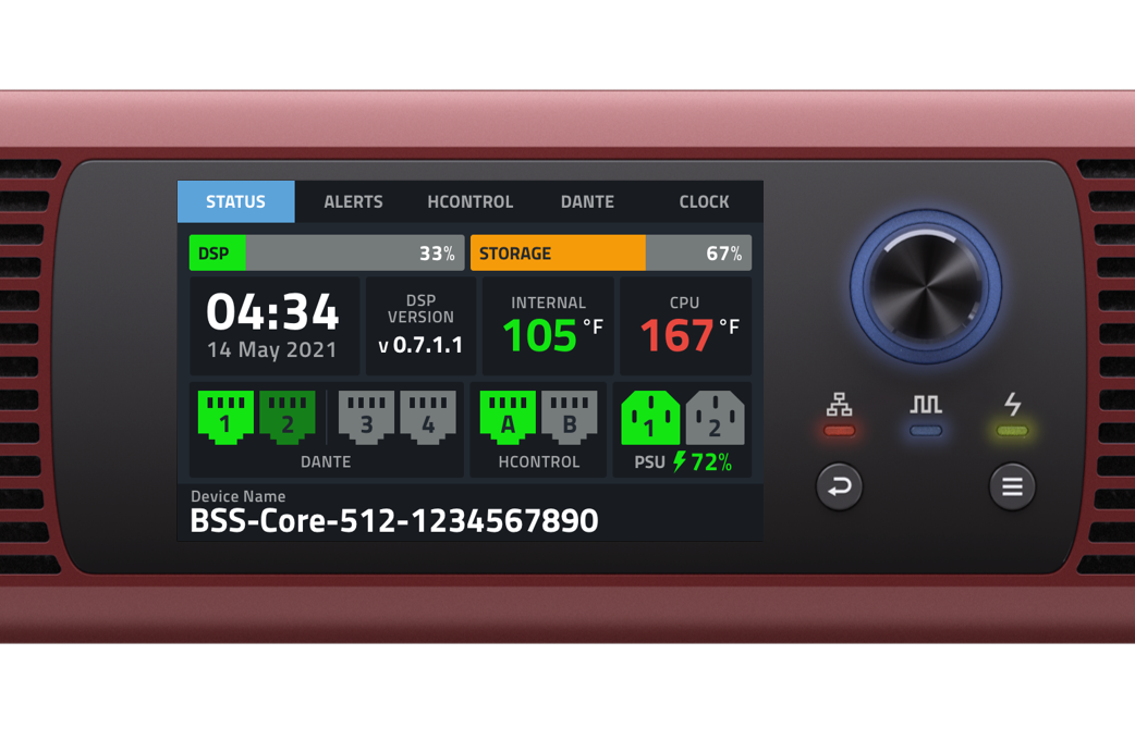

These new DSPs feature an integrated LCD display that enterprise DSPs typically don’t include. Why was it important to include with Soundweb OMNI Processors?
The integrated LCD display in BSS Soundweb OMNI DSPs provides at-a-glance troubleshooting and diagnostics, editing of IP addresses for HControl and Dante, and much more.
Great question. Actually, none of the other commercial DSP platforms on the market today offer an integrated, full-color, interactive display. These displays give end users and commissioning agents a handful of truly useful and powerful tools, including:
- At-a-glance troubleshooting and diagnostics information
- Front panel viewing and editing of IP addresses for HControl and Dante
- Because Soundweb OMNI processors contain a built-in, high-precision word clock, the display also has a clock page that indicates the current sample frequency, clock source, and clock leader status
- The home page splash screen is customizable so that users can add their own logo and other graphics
