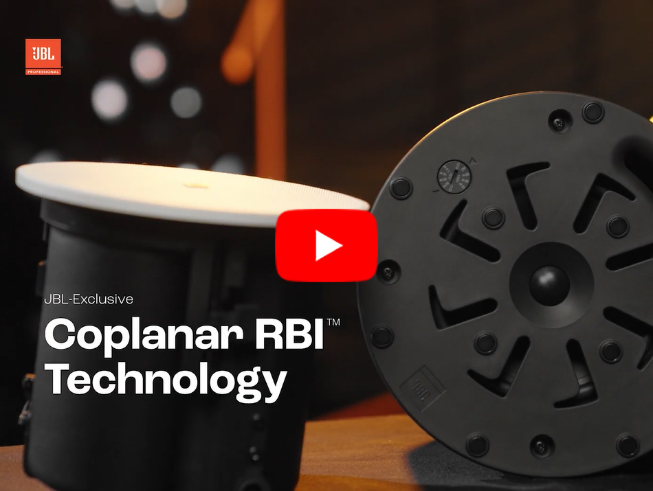

Understanding CRBI™ Technology
Q: What is JBL’s Coplanar Radiation Boundary Integrator (CRBI™) technology and how does it improve off-axis performance?
Get detailed specifications, videos, and more to explore the JBL Control 400 Enhanced Coverage Series Ceiling Speakers.
A: CRBI™ is a pattern control technology we’ve developed with learnings from our existing Radiation Boundary Integrator® (RBI™) technology. While models like the JBL Control 40 series use a three-dimensional RBI and are able to deliver constant directivity, the Coplanar RBI in the Control 400 Enhanced Coverage series is able to deliver nearly as consistent coverage at a lower cost.

Learn more about CRBI™ coverage technology in the Control 400 Enhanced Coverage Series Speakers Overview Video.
